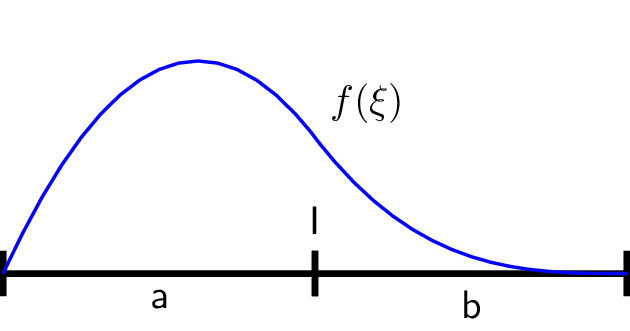

Question 1
Consider two -cells and on a one-dimensional mesh, separated by interface as shown in figure 81. Each cell is assigned a parameterization with parent coordinate running from left to right. The length of the parametric domain on cell is , and the length of the parametric domain on cell is . The mapping from the parent to the parametric domain on each cell is The degree assigned to cell is , and the degree assigned to cell is . Derive the continuity constraint on the th derivative across interface in homogeneous Bernstein form.
Figure 81: Two cells and separated by interface on a one-dimensional mesh. An example function spans the domains of both cells.

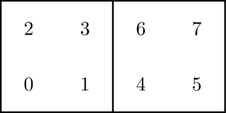

Question 2

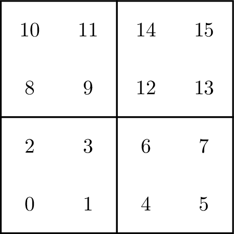

A four-element Bézier mesh with a bilinear basis is shown in figure 82. Use the provided function indexing to determine the constraint matrices for all four internal interfaces and the global constraint matrix. The interface is the bottom interface and the remaining interfaces are ordered in a counterclockwise fashion. What is the rank of the global constraint matrix?
Figure 82: A four-element Bézier mesh with a bilinear basis. The Bernstein functions are labeled with the indexing used in the exercise.

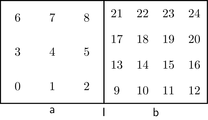

Determine the constraint matrix for the Bézier mesh shown in figure 83.
Figure 83: A Bézier mesh with two cells with degrees on the left and on the right, separated by a interface . The Bernstein functions are labeled with the indexing used in the exercise.

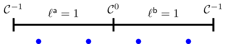

Question 4
Consider the two element Bézier mesh consisting of linear cells and a constraint assigned to the interface between them as shown in figure 84. Solve for the basis vectors of the nullspace.
Figure 84: A two element linear Bézier mesh with a single interface. The exercise is to solve for the basis vectors of the nullspace of this Bézier mesh.

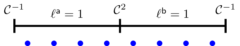

Consider the two element Bézier mesh shown in figure 85. Compute the constraint matrix and verify that one possible basis for the nullspace of is given by the basis vectors
Figure 85: A two element cubic Bézier mesh with a single interface. The exercise is to compute the constraint matrix of the nullspace of this Bézier mesh, and verify the basis given in equation .

Question 10
Write down the constraint matrix for the system of cells shown in figure 86 and draw the nonzero entries for each constraint.
Figure 86: A two-element Bézier mesh with a bilinear basis and a interface. The Bernstein functions are labeled with the indexing used in the exercise.

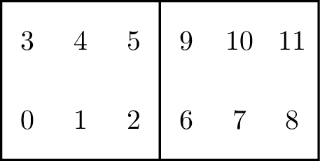

Question 11
Determine the constraint matrix and the index sets for the basis vectors for the quadratic-linear two cell example with a interface shown in figure 87.
Figure 87: A two-element Bézier mesh with a quadratic-linear basis and a interface. The Bernstein functions are labeled with the indexing used in the exercise.

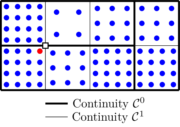

Question 13
Construct a ribbon of maximum coupling length on the mesh in figure 88, originating at the red Bernstein index near the vertex labeled with a small hollow square and proceeding to the right. Determine whether the ribbon is truncated.
Figure 88: An example two-dimensional Bézier mesh with mixed degree and mixed continuity. The exercise is to construct a ribbon of maximum coupling length, beginning at the vertex adjacent to the red Bernstein index and extending to the right.

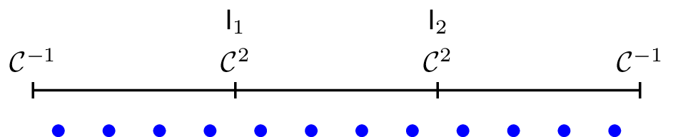

The constraint systems of two interfaces and are said to interact if the product of the matrices of absolute values has nonzero entries. Let and then the constraints associated with and interact if there exists at least one entry in the matrix that is greater than zero. Determine the constraint matrices for the two interfaces and and for the U-spline mesh shown in figure 89.
Figure 89: Three cells with cubic bases on a one-dimensional Bézier mesh, separated by interfaces. The exercise is to compute the constraint matrices for the two interfaces on this mesh.
Question 15
We showed that the number of nonzero contiguous Bernstein coefficients required for a basis vector on an interface in the univariate case can be determined from the continuity of the interface, specifically . Restricting the constraint system to the coefficients that are known to be nonzero results in a rank one system. Consider all the contiguous index sets of size from interface and in figure 89. Consider all pairings of these sets where one comes from and the other comes from such that the combined index set is contiguous. Construct the matrices corresponding to these sets of nonzero coefficients and determine the rank of the nullspace for each one.
